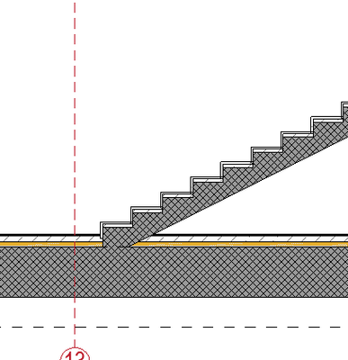

Hello,
Does intersection priority not work with Staircases? (Please see the attached image)
Thanks.

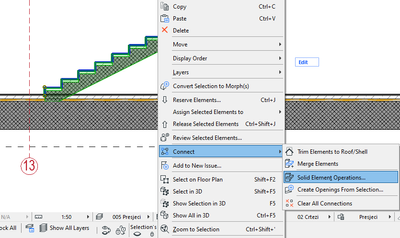

right click on the slab
3.

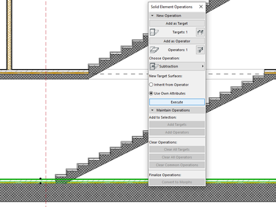

slab will be selected as target, then you select stairs and click add as operator, choose option > subtraction and click execute
3.

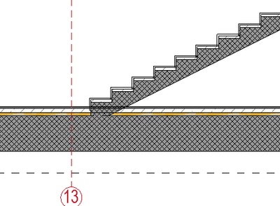

 ta-da
