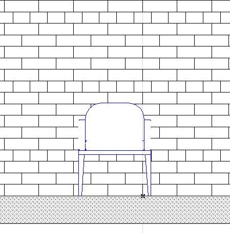

I placed a chair from the AC9 library with a wall behind it. The wall has a brickwork material applied to it, which shows with vectorial hatching turned on in elevation/section mode.
The chair blocked out the fill. Please see attached photo.
Which furniture object did you use?
Might work differently if you actually draw the fill rather than having it assigned to the wall material, which I think is what Tom is saying he has done.
