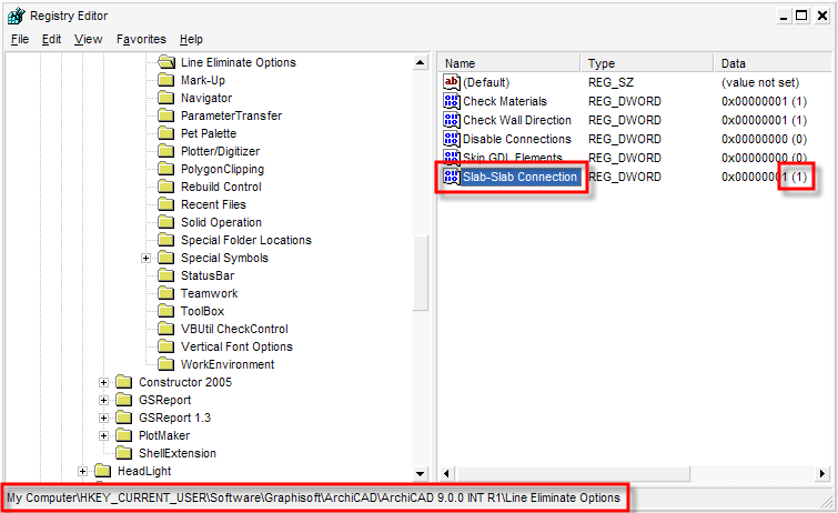

You need to set the value shown on the attached illustration to '1' in Registry Editor.
It worked for me.
Make sure to close the Registry Editor, then restart ArchiCAD after making this change for it to take effect in ArchiCAD.

for the mac users:
open the file ~/Library/Preferences/com.graphisoft.AC 9.0.0 INT v1.plist (where "9.0.0 INT v1" is your version of archiCAD) in apple's 'Property List Editor'. change the same setting lázsló has shown from "No" to "Yes".
'Property List Editor' is an application that installs as a part of the apple developer kit. if you don't have it, you can change this value using the terminal and 'writing defaults' . . . but somebody who knows far more unix than me will have to explain that one . . .
