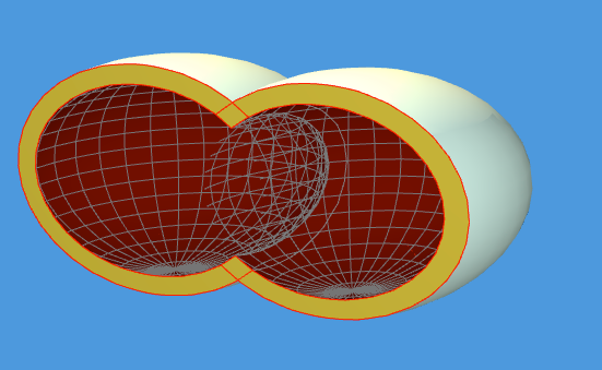

Using a Solid Element Operation [SEO], a smaller ellipsoid can subtract the innards of the larger one. I made the smaller one with an equal reduction of all axes.

Dwight, so I created two ellipsoids, one within another, then went to design - Solid Element Operation, it the SEO box - do I chose 'get target element' and then select bigger shape? Then 'get operator element' and select a smaller shape? Subtraction and Execute? Is it correct?

Dwight, I've done it. But don't know if it worked
Could you please advise me on how to make an opening in it?

Can I also show the shape I'm working on, may be it will be easier to understand what I'm trying to do?
I'd like to add opening to the bottom one and openings where the ellipsoids intersect.

Dwight
Marquee tool only lets you look inside - it doesn't cut holes.
Use other elements to cut openings with SEO. Like a slab or wall shape.
To make a hole between overlapping items, i'm not sure but you might do a double reverse SEO subtraction: A>B, then B>A.
