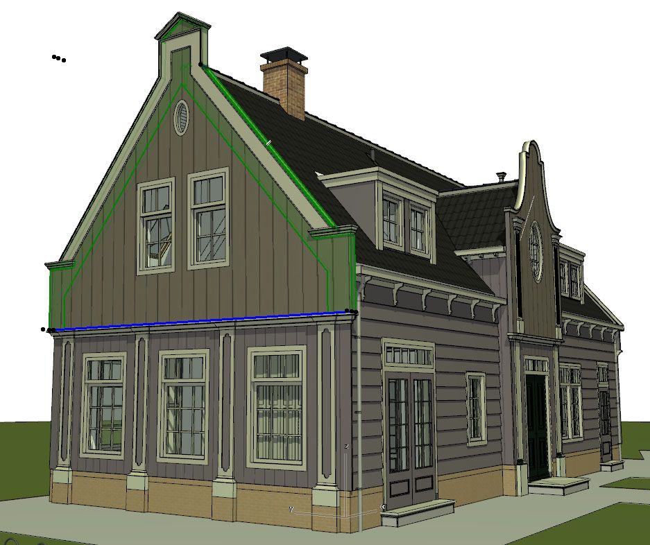

I find the rooftool quite handy to model the cap stones or whatever the covering that goes on top the wall is called in english. You can use the roofs to cut the wall as well.
Here's an example of an ArchiCAD15 project in wood, same principle.

The shape is made up of single plane roofs. One horizontal and one with same pitch as the roof of the building. I trim the wall using solid element operators.
