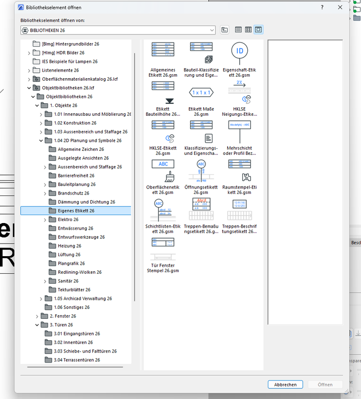

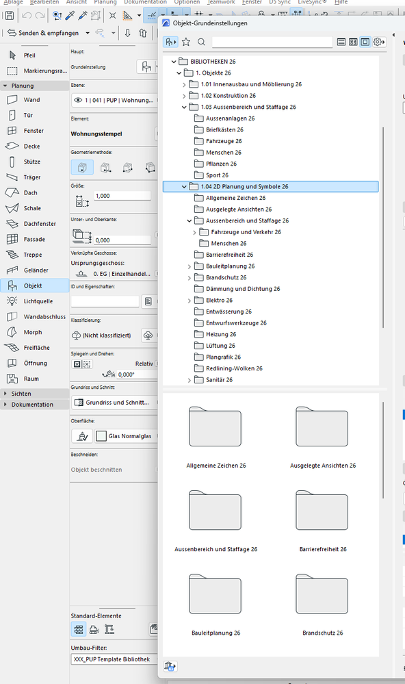

I understood your answer, but I can not find door mark in Archicad library anywhere.
Is it possible that it is not awailable from Archicad 26 on anymore?
I clicked through all 2D symbols in Archicad and could nto find it ...
I wonder now how could I change Archciad default door stamp, so it would change in all doors at once.

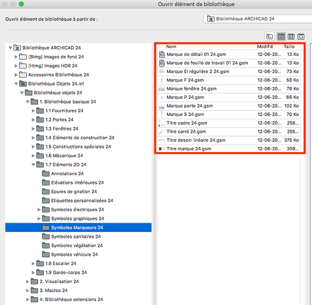

Yves

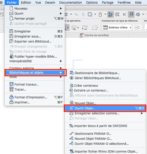

This type of object is not visible in the object tool
You have to go to the libraries and objects menu
Here are screenshots from the French version

ananas
Thank you soo much!
I finally found it!
