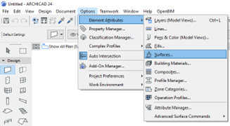

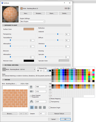

For the pen on the elevation, its built into the surface that is assigned to the building material.
Attributes -> surfaces
select your brick surface..
the pen to the right of the Vectorial Hatching fill pattern.
change from element pen to a selected pen.
i hope this helps,
