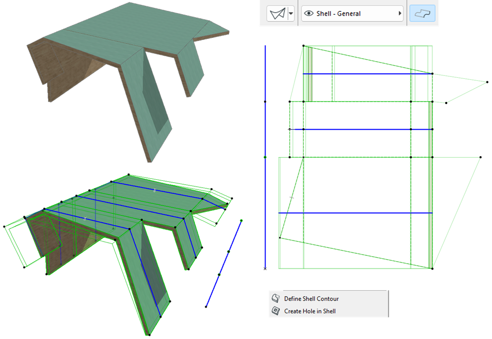

Hi @Kasski
You can try the Shell tool with Extruded Geometry Method , create as much as you need, right-click and Define Shell Contour and Create Hole in Shell if needed, as Solid Element Operations or Opening tool for windows, doors or croppings.
