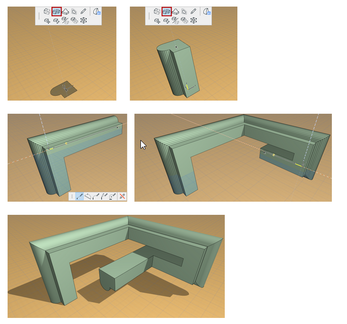

Another way - morph-face can follow an 3D-Morph-path with curves:
