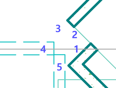

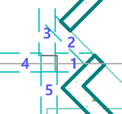

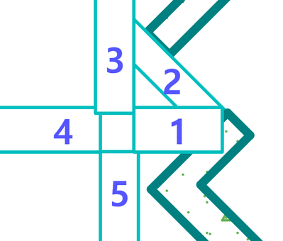

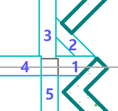

How should I set up beams and slabs in the structural drawing?
These are the beams and columns of this type.
The numbers in the explanation are display order numbers.
The pillars are not visible. It's 7.
Beam number 1 is 9->6
Beam number 2 is 9->5
Beam number 3 is 9->6
Beam number 4 is 9->7
Beam number 2 is 9->7
It's a shame that the columns aren't visible, but I'm satisfied and made a slab to make the beams hidden.
How should I handle it?

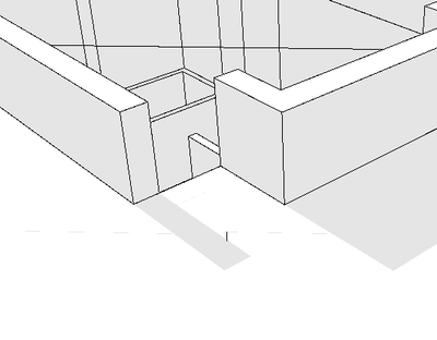

Q1. Let me ask the question again.
I'm not sure because I haven't seen drawings from other countries, but our country's drawings are drawn so that the girder and beam are not combined.
Is this possible in ArchiCAD?
If possible, I would appreciate it if you could explain how.
That's why the question above came up.
I should have explained my intention when I was asked a question, but I forgot.

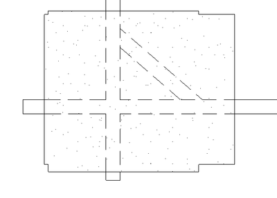

So, I first turned off the slab layer in the structural drawing and
I drew the drawing without connecting the beam reference lines.
I used a hidden line for the beam and then drew the outline again as a solid line.
However, now that I know how to use slabs, I can process outlines and beams with slabs as hidden lines, and a problem arose with the method I used. Those are the questions posted above.
The above method is what I used in REVIT.
This happens when you use the cut command without connecting the beam, so I used the display order in Archicad and it became similar when there was no slab.
Since it had to be connected to the slab in the cross-sectional view, it was not possible to separate the materials and change the connection number in the layer.
If there is absolutely no way, I will give up.
I would appreciate it if you could let me know that if you don't have it, there isn't any. ^^
