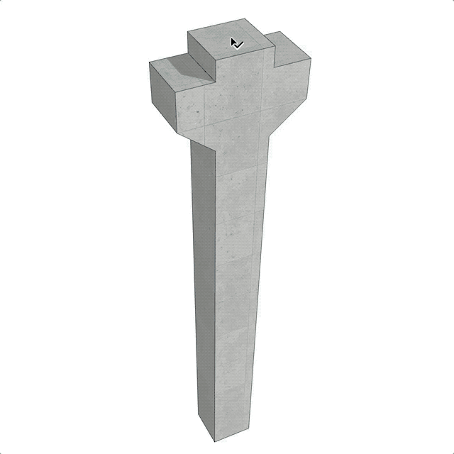

This article presents you with the detailed process of modeling a prefabricated reinforced concrete column with the new Column Tool of ARCHICAD 23.
Prefabricated columns are often used in the case of industrial halls. The easiest way to represent these structures in ARCHICAD is to model them using hierarchical segments of the enhanced Column Tool
This monolithic reinforced concrete column is 6000 mm high and is 600x600 general cross-section with the following measured leaning console:
In this article we would like to offer two ways of modeling this concrete column. The first one introduces you to how to define the shape of the column segments in the Tool Settings dialog. The second way shows how to edit segments graphically.

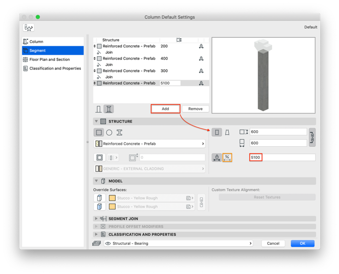

Open the Column Default Settings dialog from the Toolbox by double-clicking on the icon of the tool. The Column Tool is now a hierarchical element, and this is reflected in the user interface: There are separate pages for Column, Segment, Floor Plan and Section and Classification and Properties.
On the Column page set the Core Height to 600 mm, the Core Width to 600 mm and the Height of the Column to 6000 mm.
On the Segment page, select the column’s type as Multi-Segmented. As the Structure, select Rectangular Structure and set the Building Material to Reinforced Concrete – Prefab.
The top of the Column has Uniform Size (600x600 mm) and Fixed Length (200 mm). The Length of the Segment can be edited in the list of Segments at the top of the dialog.

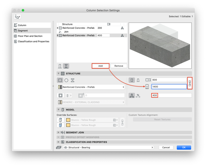

Then Add a console segment. The values are automatically set to Rectangular Structure and Uniformed Size and the same Building Material based on the settings of the previous segment. Turn Linked Dimensions off, set the width to 1400 mm and the length to 400 mm.
Continue with adding the third segment as the bottom part of the console which has a tapered size: 600 mm of height and 1400 mm of width on top and 600 mm of height with 600 mm of width at the bottom. Then set the Fixed Length to 300mm.
Add the last segment as the body of the column. It is enough to change to Uniform Size, the segment’s values will be automatically adjusted from the previous one. The remaining segment will have 5100 mm of height.
