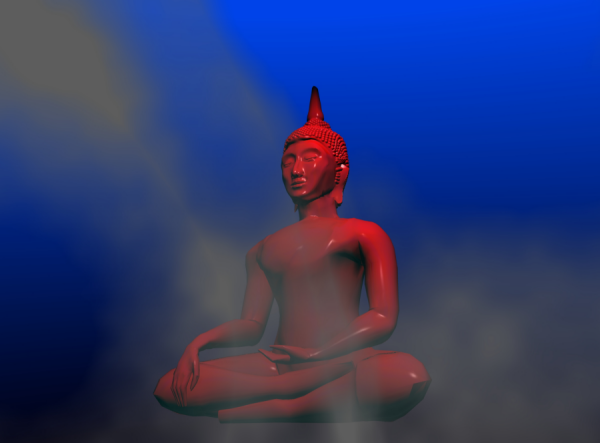

P.S. Actually, upon downloading the 3D Studio image and taking a look at it in formZ, if I can find a way to lop off the pointy thing on the top, it will do for this project as long as I don't get too close in. The poor guy has no feet!

This is what the one from 3D studio looks like.

Here's the one from 3D Modelworks. I've sent an email to the modeler to see if he can convert it to a useable format.
