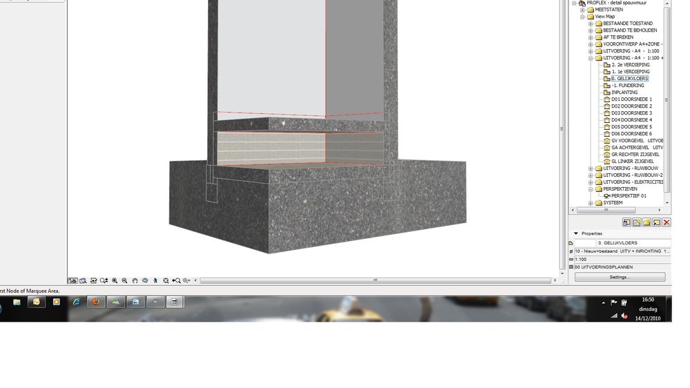

How to change material of cutted 3D?
How can I change the material in 3D so that the cutted wall, slab,...don't look all the same like in my JPG?

That value is set in the cutting plane dialog, i believe.

And if a 3D Document
Dwight Atkinson
Thank you for the quick response!
But isn't it possible to give different materials to different walls, slabs,...or can you just choose 1 material for al the cutted parts?
If you only can choose 1 material, you can't see the differents walls, slabs as you can see in my jpg...

Look at Dwight's "cutting planez.jpg", change the Fill Material & Edge Pen of Cuts from Custom to Use Element Attributes, and the materials will be as assigned to each element.
