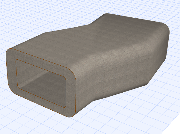

hi everyone I have one question. I know to model this in sketchup using the folow me tool, but don't no idea how to model this in archicad, i guess with morph or object? I hope someone knows

Not exactly what you show but a quick slab to morph and then extruded.
This is a bit closer.
I used Objective to rotate the slab/Morph/object first.
Although as a morph it could be rotated in z axis also
and then extruded.
http://www.encina.co.uk/objective.html
Thank you very much for the effort I managed somehow to model it
I have one query, How did you manage to rotate the morph in z axis ? I also didn't mean about extruded. Can any one help me out in this?
rocorona
You can also make a Complex profile, assigned to a Beam (or a Wall, better for curved paths), then use the Magic Wand on the path, made with lines/arcs or Polyline
In the 3D Window, select the Morph then select Free Rotate from the Pet Palette (bottom row, 2nd from left).
