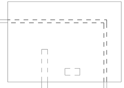

How to deal with the phenomenon that appears on the lower structural wall?
4-story structure floor plan
3-story structure floor plan
3rd floor architectural floor plan
2. I would like to use the reference line of the wall as the basis for the area. I think it's a wrong idea to think that way, but what about other people's opinions?
AC27 on window 11
11 Replies 11

LeeJaeYoung
I found that the wrong phenomenon disappears when I move the base of the wall.
However, since the area of the zone was based on the wall, I asked the second question. I also found out that the direction of the door cannot be recognized unless it is based on the wall.
So I tried not to move the reference line of the wall, but this is a question that I thought was wrong.
May I ask for a review as my work goes hand in hand with the issues below?

LeeJaeYoung
What I can do to turn off the phenomenon on the lower wall is to change it from core center to core outside.

LeeJaeYoung
I find the language really difficult.
So I thank you for bringing me here.^^
The technical question refers to a problem that does not appear to be a problem with the walls on the current floor, but when viewed from above.
To solve this, a situation arises of shifting the baseline.
This is what happened when I had to change my thinking about the zone area I was building. To secure this, you can replace LINE etc. with borders. I made the boundary of the zone only with the line with the judgment that making the zone with the wall line and the line as a boundary can cause many mistakes in my opinion. But this time the location of the doors and windows caused a problem.
1. Is it correct to obtain the real name and area at once with zone?
2. How should I make the area?
3. How do you handle the lower part in the structural floor plan?
If possible, I would appreciate it if you could show me the drawing. ^^

I will try to guess -  in your floor plan display change to be shown to home storey only instead of relevant stories. I think that wall of yours is either very tall or elevated up to that storey that's why its being shown in the plan. If you want to reference it from below you can always use the trace and reference function of Archicad. Hope this helps. 😎
WINDOWS 11 PRO
LeeJaeYoung
in revit
If you do home storey only, you cannot express the lower wall in the structural drawing.
In Revit, the wall column beams are hidden when switching to the structural drawing as shown in the image above. By the way, archicad has options for columns and beams.
However, there are no options for walls.
Then there should be something, but it's not even in the GOC.
There is only an ignorant way to designate each floor.
(Now I'm judging that this is the correct answer. ^^)
Is there a way to treat the lower wall?
