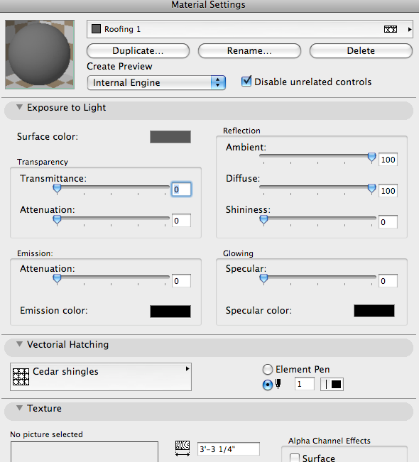

It's just the standard Internal Engine... shading, well.. I'll attach a screen shot:) (The background color is just for my web site images, keeps it simple in Photoshop.)

hummm??? I didn't actually switch any lines? The black for the siding, or the roofing comes from the material settings. But, maybe you are on to something else

Are your materials vectorial hatches set to element pen or custom? Maybe that has something to do with it. And do you typically use black pens? It looks like it from your plan. My drawings are all shades of the rainbow... well a couple shades!
Okay, well your correct images answers that question! Yes to both.

"Are your materials vectorial hatches set to element pen or custom? Maybe that has something to do with it. And do you typically use black pens? It looks like it from your plan. My drawings are all shades of the rainbow... well a couple shades! "
How do i change pen or custom? And how do you change black pens. I hope I don´t ask to much stupid questions.
