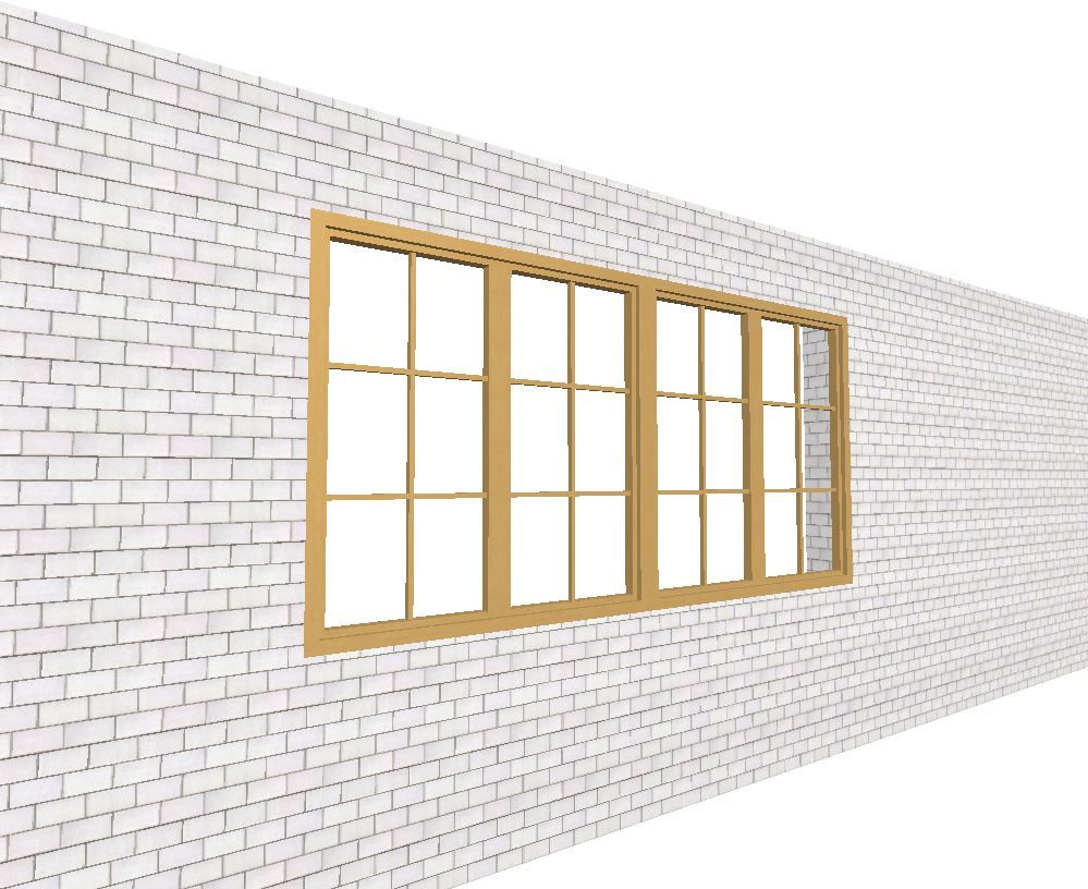

How to make Casement Window with 4 sashes?
I want to make Casement Window with 4 sashes. But there is no option to increase the number of sash frame in Casement/Metal Windows. Is there any way to make this?

Does this image help?

You may use w2 casement window double to get 4 sash window.
For the right 2D represantaion , you have to use "stacked window" parameter
You can also use the ribbon window and pretend they are operable.

I mean gergazi's explanation. I did it by WRibbon10 but its not the correct choice. Because it is a fixed window.( there is no leaf to open)
I did it by gergazi's way. I think Graphisoft should add more options to make the windows
