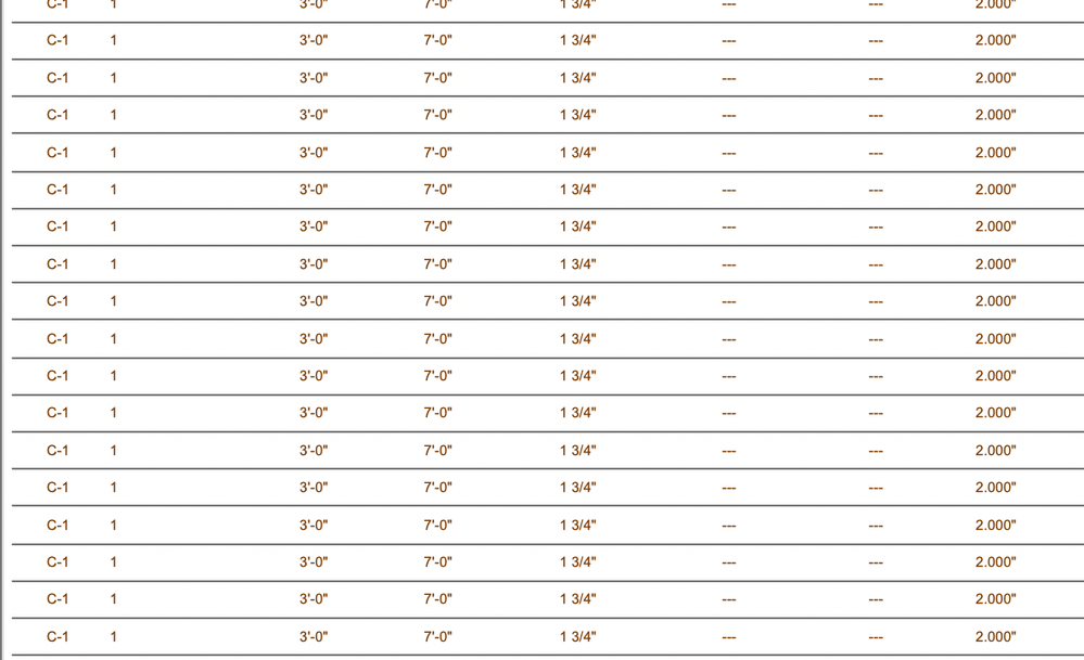

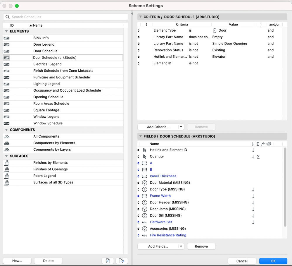

Hi all, I cant figure how to make the door schedule say "C-1               10" Instead of listing each and every one of the doors that Id'd as C-1. You can see they all have the same criteria, so i don't understand why they wont merge.

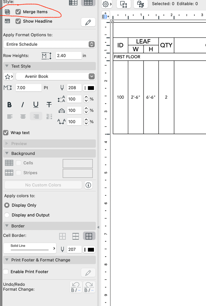

Open the schedule (Document/Schedules) and try checking this box:

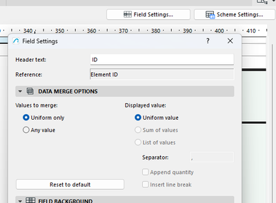

At the top right, you can edit how it merges under Field Settings. By default every field must be identical, but you might have something like a location note, that you want it to ignore.
