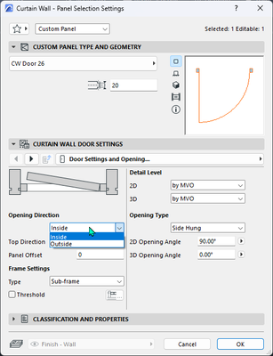

2023-06-21 05:17 AM - edited 2023-06-21 05:36 AM
I made a curtain wall with 3 lines with this command.
However, the mullion interval is applied only to the first line, and the mullion interval cannot be specified for the second line.
1. I want to know how to specify mullion spacing on the 2nd 3rd line.
2. I put the door in, but I couldn't adjust the direction of the door.
Can you tell me how to adjust the orientation of the door?

2023-06-21 07:45 AM
In Out knows.
I can't find anything to change left and right. ^^

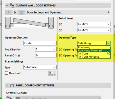

Also, is it not possible to change the left and right of the door?
Do I need to generate GDL separately?
2023-06-21 09:52 AM
I don't use curtain walls, but a little investigation I found this.
2023-06-21 10:59 AM
I thought it wasn't here. ^^
thank you

2023-06-21 05:37 PM
Woo ha ha ha
I thought this wasn't really true, but I think it's a difference in words.
I never imagined that the open type could control the direction. ^^
