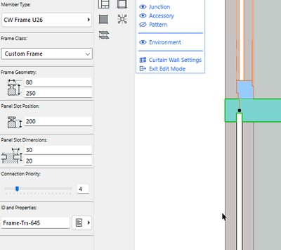

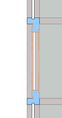

How to place the vertical frame in curtain wall ?
LeeJaeYoung
How to place the vertical frame?
The first frame works, but the second seems to repeat again.
Is there any other way?
1. Should I make one?
2. Where can I watch the basic curtain wall tutorial video?
3.
3. Can you figure out how to change the direction of the door?
AC27 on window 11

LeeJaeYoung
I made a curtain wall with 3 lines with this command.
However, the mullion interval is applied only to the first line, and the mullion interval cannot be specified for the second line.
1. I want to know how to specify mullion spacing on the 2nd 3rd line.
2. I put the door in, but I couldn't adjust the direction of the door.
Can you tell me how to adjust the orientation of the door?
Thank you so much. ^^

And the mullion interval of the first line in the question above can be specified.
This seems easy enough for anyone to understand.
However, I don't know how to specify the mullion interval of the second and third lines.
So I adjusted this in plane.
It wasn't the shape I wanted.
So I had to redo it in 3D.
I'm guessing this isn't the answer.
