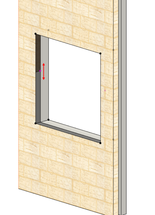

I think I used a Window Niche to faux it previously since you can assign an independant Surface to the niche. Obviously this requires manual setup,

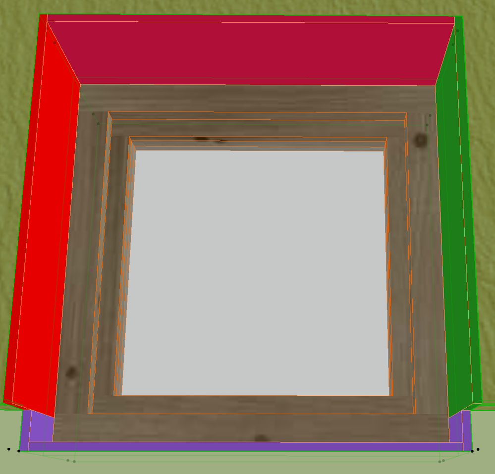

I tried using code. I duplicated the Archicad window and made it "my own". I inserted parameters in the window and added code, but it's not working out so well so far. It places a niche somewhere else. Is there any possible way you could help me with this? Or, if not, could you please send me a simple window that utilizes that niche for complex walls? Im new to Archicad and it helps me build everything faster, but there is a strange rule in my country where a house has to have that bottom height with f.e. 5cm strong Styrofoam and above it a soft one. As shown in the images I placed in this article.

Quick update, i managed to make what i want. So basically, with running through some articles and using help from ChatGPT, i managed to make it. I added a small thickness on the side so it goes over the wall complex and made four parameters for fill surface. In the code, i can change the thickness and depth of all 6 strips i have. Why 6? On the bottom of the left and right strip, I have different depths on the same strip side, so i need to have a chance to change the height and depth of it. The image attached is showing what i wanted. If any "problems" or issues could occur with this, i would be glad to hear it.
I have added the split wallniche to the simple window opening.
Zip file is attached for that object (it is actually version 22 so most people can use it).
It is only the outside reveal that is split.

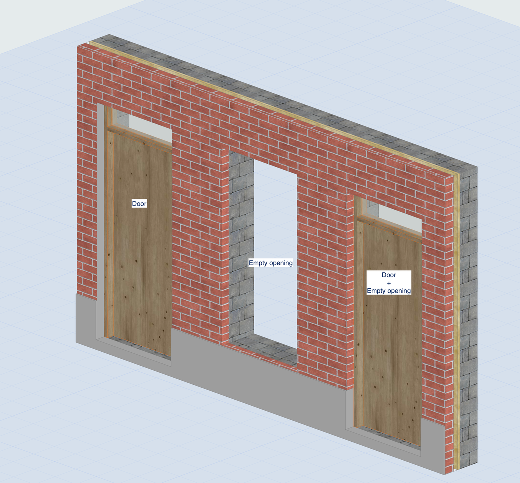

cuba
Another workaround: add an empty opening (and make it slightly wider 1mm), the sill of the opening must start just above the plint to keep the material
