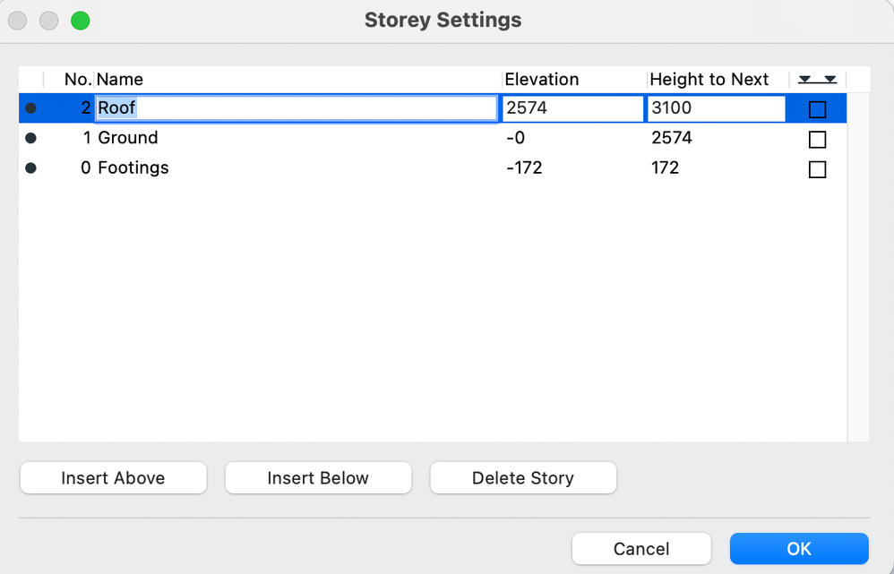

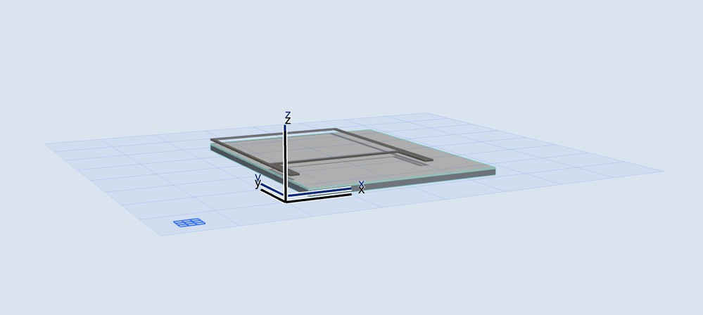

I created a simple cabin in Archicad but the walls have no height in 3D mode or elevations.
K McLachlain
Beginner
I don't know why the model still looks like a 2D drawing. I went into storey settings and checked the heights of each storey. The height of the ground floor is set at 2574mm, so I am not sure why no height is showing in 3D. There was a problem with the height of the footings level which I have now adjusted but it made no difference.
I have read some of the replies to posts on similar problems but being new to Archicad, I have no idea what the people offering solutions are talking about. If anyone could offer the 'Archicad for Dummies' wording for the solution, I would be very grateful.
Thanks, K

Can you select a wall and show us the top and bottom height settings?
Kamelite
Are the walls linked to the current storey and the storey above?
.Kamelite
