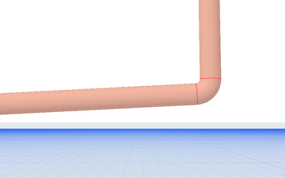

I'm trying to model a pipe route in the new MEP modeler in Archicad 27. Unfortunately, I can't enter the pipe slope in any way. There is a field to enter the slope in the infobox, but I can't type anything in it (see attached pic). It can't be done in 2D or 3D. The slope of the pipe cannot be entered either when editing a finished route (I can only manually edit the heights of individual junctions, but this does not allow me to work with a specific slope in %, or I would have to manually calculate the heights).
Is this a bug or am I missing something?

Hi @Martin Jan Rosa
Did you clicked the lock icon next to the slope percentage? It supposed to be locked by default (same way as our stair works) and you should unlock it first to add a slope value in it.

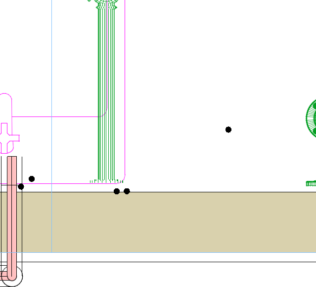

Just tried it, and really the only way that seems to work is changing angle of the endpoint, at least in 3D. The slope i can't work out, just wasted whole evening with it and no luck. But they definitely have changed the way how MEP operates. Even the MEP sub menu from drop down menu is gone now. Also noticed i can't edit plumbing done in version 26. When creating a new object, it basically doesn't show even though the routing line or at least points are visible in 2D (see the last pic).
