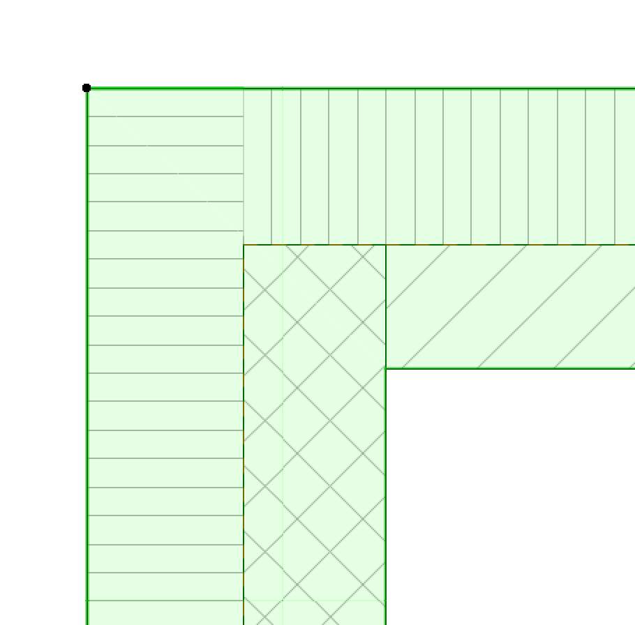

Hello I'm having a problem with how the hatch of the insulation connects, I would like that the hatch to connect at 45 degree angle (in image 1) but it only does that if the wall is exactly the same, if I have a different composition (brick instead of concrete i.e. it connects at 90 degrees) is there a solution to this ?

This is the incorrect rendering that I get now.
Dontknow
Looks like your using two different composites in de incorrect version.
The hatch of the insulation is different in each wall.

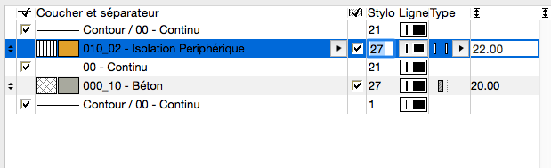

I'm using the same hatch for the insulation it's the masonry that changes (one is concrete the other brick) I will add the images of the composites maybe i'm doing something wrong!
second composite

Working just fine over here.
Make sure you've got the construction line of both walls connected.

Luís, Veja as definições (ver anexo)

So, what JLopes is saying that in the Building Materials Dialog you have to take the Building Material of that skin and make sure the Fill Orientation file is set to "Project Origin".
I do have it set to element origin (it's the exterior parallel line hatch that is causing the trouble not bricks and concrete) and the walls intersect.
It's weird I think I did something wrong but I can't find what
