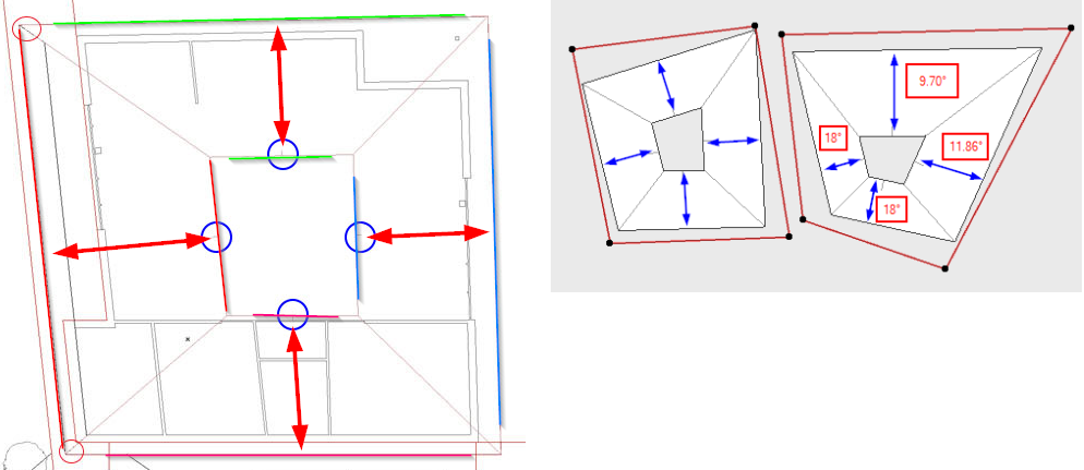

I am trying to connect single plane roofs together, as I need to create a roof with an odd geometry (refer to attached img). I have used SEO to connect 3 out of 4 planes, but the corners of the 4th don't seem to match the ones (refer to attached img). I know that its a weird geometry but it should be a way around it.

In addition to Karl's advise about moving the Roof edges for easier intersecting: be sure you are clicking an edge (mercedes cursor), not a node or point (check mark cursor), clicking a node will bring up the Roof Elevations dialog box. Also, in your screen shot of the roof plan I do not see the Roof Pivot Lines, they can be shown with the Show/Hide Roof Pivot Lines command. In your case, it may be best to place the Roof Pivot Lines at the outside Roof edges so you know that the 4 Roof edges are at the same elevation and the slope is perpendicular to the Roof edge.

Looking at your original screen shot, the roof planes have different dimensions from interior edge to exterior edge. If they also have the same slope, then the exterior edges will be at different heights. To adjust the slope of the problematic roof you can try this:
1. Select the Roof you don't want to change (will remain as is), place the cursor on the corner exterior node (checkmark cursor), and Ctrl-click (Windows) or Cmd-click (MacOS), the Roof Elevations dialog box will appear, select one of the Bottom elevation heights and copy this dimension. Cancel the dialog box.
2. Select the Roof you want to change, and again place the cursor on the corner exterior node (checkmark cursor), and Ctrl-click (Windows) or Cmd-click (MacOS), the Roof Elevations dialog box will appear, select the same Bottom elevation height and paste the dimension. OK the dialog box.
This will alter the slope of the Roof so its corner node is the same height as the other Roof. Again, try the Intersect Roofs method to get the correct valley between the two roofs.

Here is an image in which I tried to explain why this scenario is hard (as you change Roof Slope, vertical thickness of Roof changes, plus you want to have the top of the Roof at certain height at its eaves and ridges, but you can only control the elevation of the bottom of the Roof via its Pivot Line).
If you look at the Section you will see that it is relatively easy to calculate the Roof Pivot Line Height and Roof Slope from the values of the desired Eaves Height, desired Ridge Height and perpendicular distance between the Eave and Ridge on the Floor Plan.
After you do this you will still need to set the Roof Edges to the proper angles, but that is a smaller task compared to this.
Edit: actually you don't need to go to the Section each time as I wrote in the image because you can measure the perpendicular distance between the Eave and Ridge on the Floor Plan as well.

As Laszlo said... It will be really hard to do it using roofs, as they only have a single constant slope perpendicular to the pivot line, so if the opposite end (to the pivot line) is not parallel, each end corner will have different heights. Try that with four different roofs (with different odd connection angles in plan view) and you've gotten yourself a roof nightmare.
I am assuming that the geometry you are trying to make is kind of deformed; I mean, not constant in the way the roofs and its pivot line work. In attachment, in the two right side examples, end roof lines and pivot lines are parallel, and even with strange angles between roof's pivot lines, there's a way to adjust slope for each and keep every end line in the same Z position as long as that rule is met. Try to make them with the red outline and there will be problems.
This is a great opportunity and ideal scenario to use the shell tool. It'll be super easy to do what you want with four ruled shells (or even a single one could do). You'll loose some info from the roof tool regarding slopes, but it'll be really easy to model.
Or... as a last resource, use two meshes. First model roof top surface, then copy that mesh and lower it to use as SEO operator.
Hope I did not misunderstood and that helps a bit.
