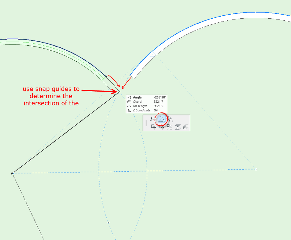

Hello, I would like to intersect these two curved walls, but it intersects wrongly. How can I fix this?

I guess it might depend on the curves, but intersect worked for me.
Otherwise I would just stretch the circumference with the pet palette option.
Or just delete those extra bits after doing what ever it is you did.
Lingwisyer
Guru
I find this usually happens with CPs. Sometimes changing the Junction Order can help. Can you flip your reference line to the inside?
