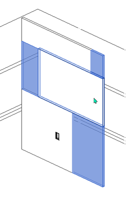

Even if you lower the wall above after copying, the windows above do not disappear.

Yes you will need to edit the widows as when you copy the wall it copies the windows too.

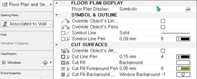

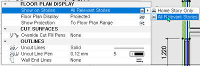

But as in your other post, when you have separate windows on each storey, you will need to play around with the Floor Plan Display options for those windows so they only display when cut by the Floor Plan Cutting Plane for each storey.

When you copy a wall with windows or doors within it, these windows and doors are also duplicated and if they are set to Sill / Header to Storey they will remain where they are even after you change the host wall to single storey. So you will need to removed these duplicates. You should just be able to select your wall on each storey, isolate in 3D and see the duplicate windows floating outside your now single storey wall.
