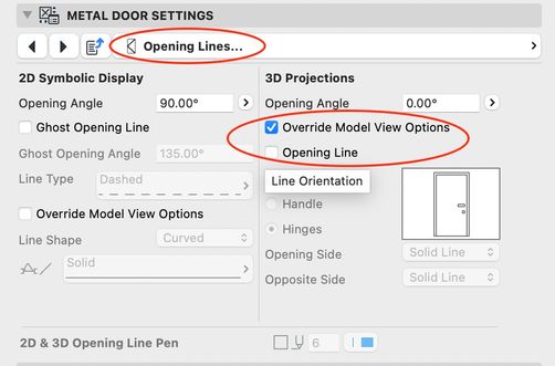

Disable the opening lines in the door settings as shown here.  Note that this permanently eliminates the opening lines in all views:

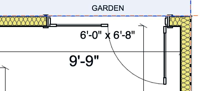

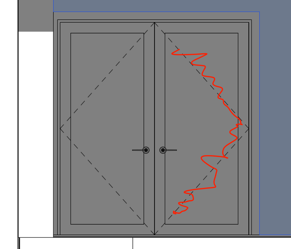

INTEXHOMES
If I have a double garden door. I need to show that one side opens and another side is not. If I disable opening lines, it disables it for both leaves. I need to keep it for one leaf and disable it for the other leaf.
Screen Shot 2022-10-05 at 11.28.10.pngScreen Shot 2022-10-05 at 11.27.49.png
Unless there is an option in the object to make one of the leafs fixed (I doubt there will be - the idea of a double door object is that it will have 2 opening doors), you will have to resort to white lines to cover the door swing lines.
Or turn them all off and draw in the ones you want.
