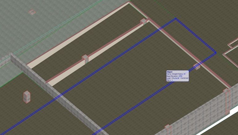

After reinstall, I found it it easy to work with.
After a night when I go to sleep, it go back to it old style.
Any one might know how to fix this?
Reply asap.

This is my case.
I found out that using what you saying and use Inherit Attributes of Operator would work.
However some of the column just wont.
Any reason for that.
