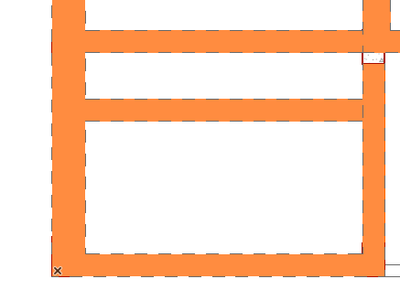

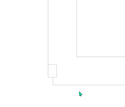

1. Columns are not visible!
Pillars were installed on the first floor and beams were installed on the second floor.
After that, the pillar is not visible.
So I had to raise all the columns to Display order.
Is this the only way?
in archicad
It doesn't seem to have priority over the beam of the column.

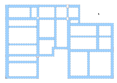

in revit
in archicad
in revit
I'm not saying REVIT is great.
There are many disadvantages than Archicad.
However, as a user, there are such advantages, so we are asking if it is possible in ArchiCAD.

Steve Jepson
SEO  🙂   Solid Element Operations
This is what you want to know about.
