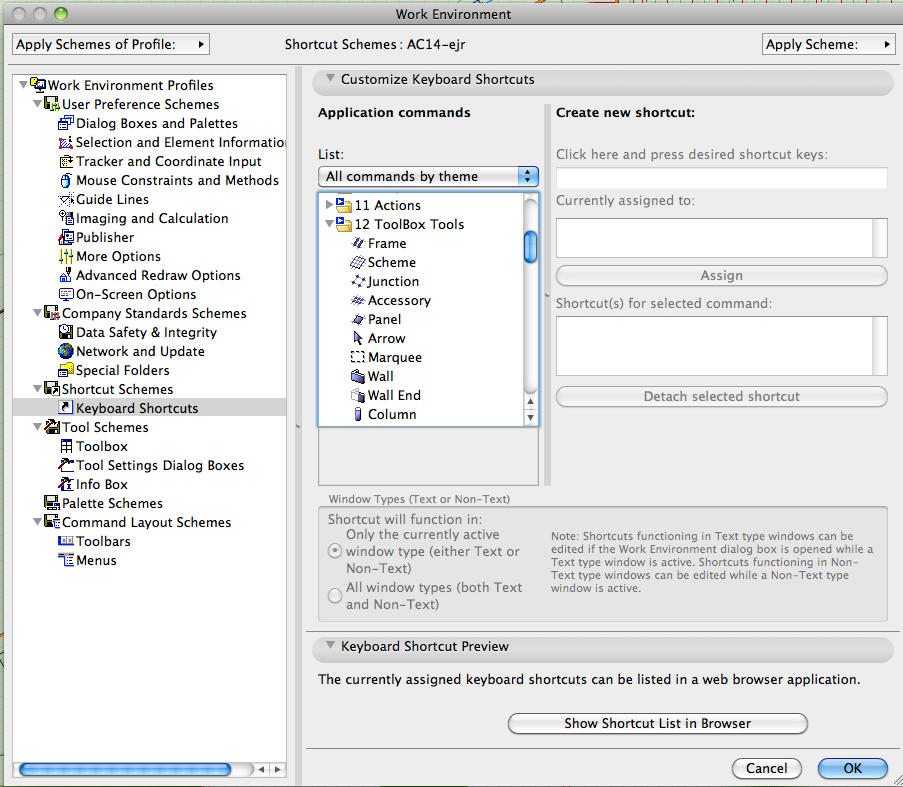

David Wylie
1 = pick tool, old AC shortcut that I got used to
2 = marquee tool, old AC shortcut
How do you asign keyboard shortcuts to 'pick' and 'marquee'? I can't find a way (they do't seem to be on my menus).
Thanks.

Eduardo Rolon
In your work environment settings -> under shortcuts -> filter by "all commands by theme" -> look under "Toolbox Tools"
