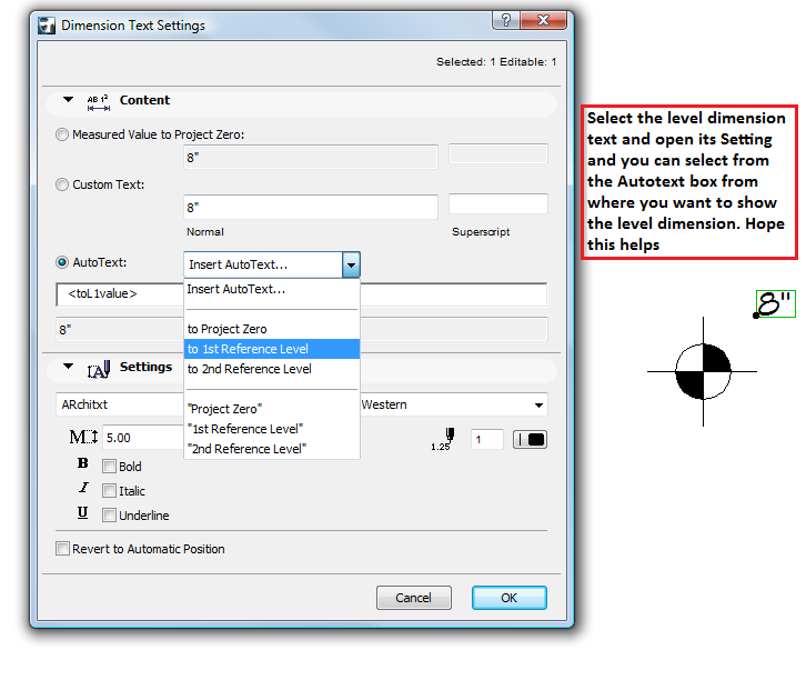

Is there any way to get level dimensions to refer to the 1st Reference Level as opposed to project zero? I would like to give ceiling levels on the first floor of a building so that they read from the first floor slab.

You need to select the dimension text from the level dimension and open its properties to make it show the value from the first reference level dimension.

Thanks Srinivas. That's exactly what I needed.
