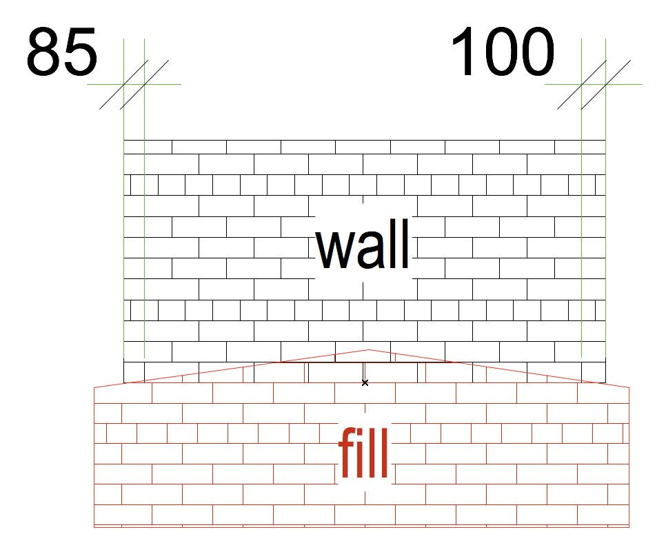

Well I analyzed it in an elevation window and can't say I can confirm your findings.
Even the same (drafting) fill using the same fill as the hatch doesn't line up with the wall's hatch that is centered on the project origin.
And the hatch isn't centered exactly (as per the dims).
Close, but no cigar. How'd you go?

Hello Link,
I am surprised you could not reproduce what I had found.
I do notice in your image that the project origin is not
centered on the center of the wall but slightly off.
I am going to try it again in AC 12 and see if I get the same
effects that you get in the Section/Elevation window.
I did try a diagonal fill material in AC 12 (chain link fence)
and did not notice anything unexpected.
Thanks,
Peter Devlin

Actually the wall is centered on the project origin - it's the hatch that's not centered, which was my point.
Maybe try assigned a diagonal block or brick fill as a hatch to a material and the model two walls in different directions. It definitely sets the direction of the fill. I remember GS telling me via a bug report many moons ago. Never asked about the origin of the hatch AFAIR. I would have assumed it would be based of project origin, but it seems not?
Cheers,
Link.
Hello Link,
Setting the wall tool to have a brick running bond vectorial hatch,
I drew two walls one under the other and dragged the upper wall
by it's center to align with the Y axis of the project origin
and dragged the lower wall by it's center to slightly to one
side of the Y axis of the project origin. The 3D vectorial hatch pattern
of both walls is centered on the origin but the the pattern on the
upper wall is centered on the wall (symmetrical) while the lower
wall's pattern is not centered at the center of the wall but is offset
meaning not symmetrical because the lower wall is not centered
on the Y axis of the project origin. I seem to be able to get the
hatch pattern to center yet you don't. Please see attached.
I'm sorry Link, I don't understand why we are getting differing results.
Peter Devlin
