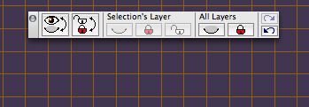

Are you using the Quick Layers palette or the Quick Elements palette?
Cheers,
Link.
Dwight
When i click "Quick Layers" I get this palette
