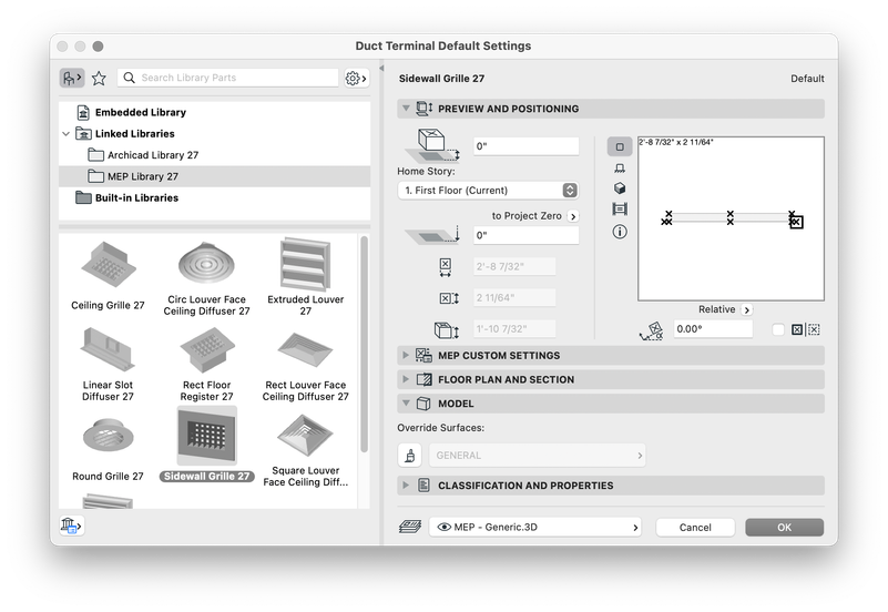

I can't seem to find any wall diffusers only ceiling.  What am I missing?
16" MacBook Pro M1 Max
Mac OS 26
ArchiCAD 27 Build 6010
David Maudlin
Rockstar
Chris:
It is in the MEP Library 27.
David
David Maudlin / Architect
www.davidmaudlin.com
Digital Architecture
Chris Grantham
@David Maudlin I discovered it about a minute before you posted that. HA! I guess I had my blinders on.  Thanks for the reply!
