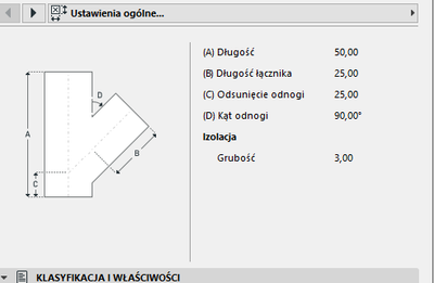

– No parameter editing for tees. They are generated automatically and their parameters are locked, so you can’t create custom tees (e.g. 20/15/15). In Archicad 25, you could still make your own objects — maybe not perfectly, but at least there were some workarounds. Here, there are none (or I haven’t found any).
– No control over branch height in tees. The outlet position generates automatically, and all its parameters are locked. (It can only be changed in the route specification, but that affects all tees in the entire system.)

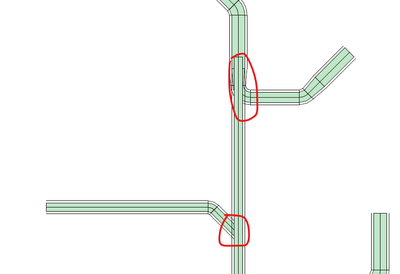

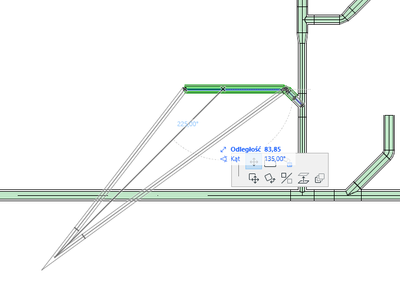

– Element movement is unreliable. The “offset object” option (shown below) appears only in specific cases. Normally, you have to use “change position – move”, which later breaks connections, causing issues like the ones shown below.
– Strange glitches happen sometimes, e.g. a move point gets locked somewhere and you can’t add a node or move anything, because it automatically snaps to a random 2D/3D point.

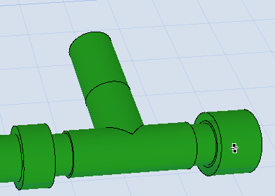

– After switching to flanged connections, some elements stop responding. For example, I set the entire route to be insulated, yet one element ignores the parameter completely. Sometimes flanges don’t appear at all.

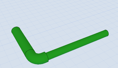

– When inserting two elbows using the new “double elbow” function and the connections are flanged, the result looks completely unrealistic - there should be 1 flanged and 1 not just like connection works in real life.

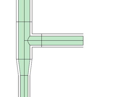

– Sometimes things just break — even with the same diameter, inserting a tee can produce something like this (see image).
