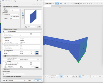

How does one control the size of a duct system end-cap using the new MEP modeling tools? The relevant parameter is greyed out.
Operating system used: Windows 5003 USA Full
2 Replies 2
s_p_b
The junction tool also has (C) Branch Offset and (D) Branch Angle disabled. Anyone know why? The branch is simply too large and overlaps with an elbow in the same duct run.

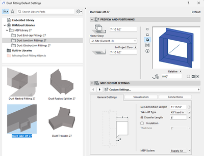

I also don't understand the Duct Take-off object. The object settings illustrate that it attaches to the side of duct run, but it can't be placed like that. I thought it might be possible to change the duct branch to use a takeoff object, but it only works with the one default library object.

Hi @s_p_b ,
I’m sorry to hear about the issues you’re experiencing. Our new routing mechanism is designed to provide a seamless modeling experience, minimizing the need for individual tool selection. However, we’re currently in a transition phase, and some aspects may not work or require temporary workarounds.
Here are my responses to your concerns:
  1. Regarding the bug with the End-cap’s functionality, I’ve logged it in our bug database. We’re committed to resolving this as quickly as we can.
  2. The branch element is automatically generated from the connected route elements. Currently, only the default settings can be adjusted in the element’s settings dialog, and manual placement is not an option.
  3. The duct take-off object is not supported in the current version. However, we’re planning to include it in our next release.
