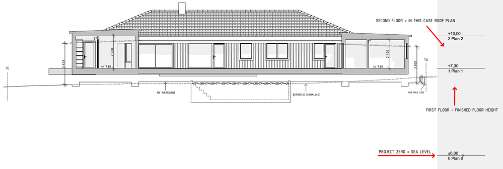

Ok, I´m not really sure if I understand you correctly and now I'm starting to wonder if I'm doing something wrong when modeling...
This is a reconstruction/extension I´m working on for the moment, here is my story settings right now:
Here is a clarification from one section:

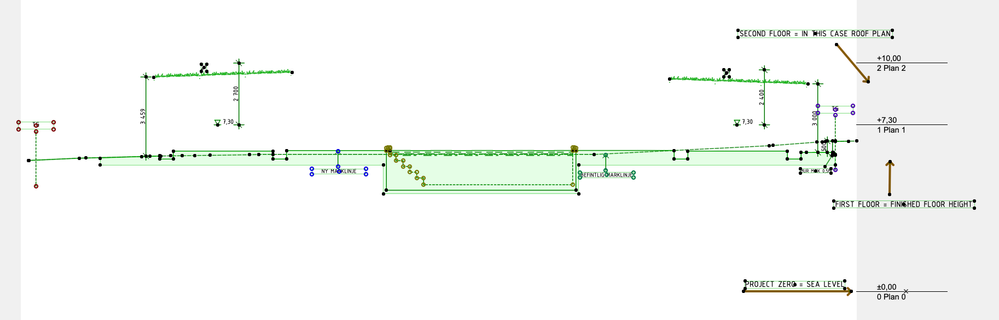

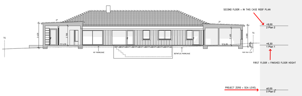

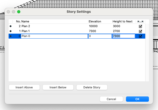

Now... if my customer comes to me after I have worked with his model for a while and says he want´s the building to be a meter higher.
Sigh, of course, no problem, I´ll just do this:
I change the height to next to 7300 from 6300 on my ground 0 floor, I have this plan named "Plus height zero" all the time and it´s based on sea level (at least in my world).
 Volá! My client is super happy...
Now I just need to manually move all my 2D graphic such as ground lines, measurements (that haven´t snapped), plot boundary, text, covers for the ground etc. as you can see, in all of my section/fasade views.

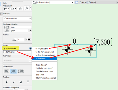

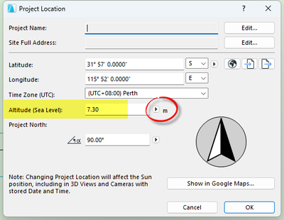

Solution
What you have done is move the entire model up (except the annotation), and it is exactly the same model - just higher in the air.
You will probably need to adjust all of the section and elevation views on the layouts as well.
All that has changed in your model is the storey heights.
Seems logical enough, but as you have noticed the annotation in elevations does not move.
All you really need to do is set your ground floor (what you are calling 'plan 1') as storey 0 (it is storey 1 in the USA template).
In Options menu > Project Location you would set your Altitude (Sea Level) reference to 7.300
Note the height is in metres.
I said before set it as a negative value in Projects and Preferences > Reference Levels.
You can't actually set it there but it will automatically show as a negative level.
Now all of your level dimensions and storey heights, you can set to reference from Sea level.
If you need to adjust the floor level, you just adjust the Altitude (Sea Level) again in location Settings, and all of your linked heights will automatically change, but you are not physically raising or lowering the model and all of the annotation.
