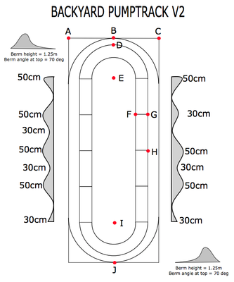

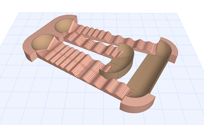

I am making a pump track in Archicad. I managed to make a somewhat believable track, however I am having problems with endings (see attached pictures). I made custom profile for curves, and the track itself with extruding morph.
If you think it's possible to do it with shells or something else better, I will, I just need it to look good.
Thanks!

What is it supposed to look like?
Can you show an example?
Charlie64

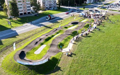

I basically tried to copy this floor plan and section which are not from the same pump track.
This is not a real project so the dimensions are not really important, that's why I drew only one track and copied it.
However, I still want it to look okay and learn how to do it better.

Could you use a Ruled Shell to do the transition from the pump to the berm?
