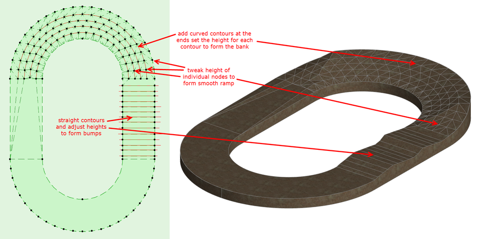

I am making a pump track in Archicad. I managed to make a somewhat believable track, however I am having problems with endings (see attached pictures). I made custom profile for curves, and the track itself with extruding morph.
If you think it's possible to do it with shells or something else better, I will, I just need it to look good.

I think I would tackle this with the mesh tool.
Map out the shape of the track and then add contours across the width of the track that you can set the height for.
The more contours you have, the smoother the bumps will be.
The curved ends might need a combination of curved contours and individual nodes to transition between the high bank and low track.
In my head this should work.

It took a couple of tries, but it worked! Thanks!

I am unsure what you mean with curved contours. My mesh does not allow me to curve the line that connects two points on a different height, only on floor level.
Thanks!
Here is my quick 5 minute attempt.
You can adjust heights of all nodes on a contour, or you can manipulate each node individually.
You can even adjust them in 3D.
