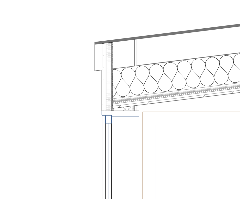

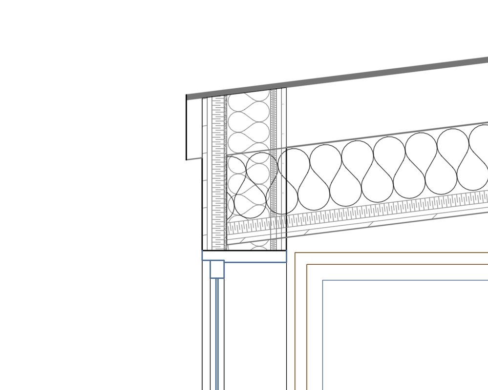

Why is it that the material priority isn't working between roof and wall: in both method : without seo and with seo upward extrusion?

Use Connect->Merge function.

Some elements have automatic connections (automatic priority based junctions) and others don't.
It is all explained in the reference manual - search for Model Element Connections.
Thanks! it worked, my ignorance!!!
