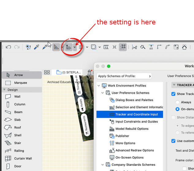

Do you mean the tracker that appears as you draw the wall?
First, I select the wall tool or any line tool and then specify the measurement for the direction I want. After that, I press enter, but the wall or line goes in the opposite direction.
Make sure your tracker is set to use relative co-ordinates.
Hi Barry.
This is the setting. Should I change it ?
Yes those settings in the Work Environment are good and the setting I am referring to is in the tracker icon.
Aha, I found it. It's on.
