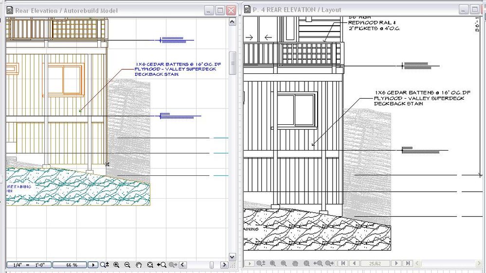

Hello Talkers,
I have been setting the model values of my site mesh to earth (with a vectorial hatching fill of earth fill out of the box) or a material with the Stone Surface fill. (actually a copy of the stone surface fill with the Scale Ratio set to 0.8 & 0.4) for the Skirt & bottom materials. I am usually setting the Top material also to a material with the stone surface vectorial hatch. the elevation views slow down a bit and also the 3D Axonometry views. In my latest project the elevation layout generate, a layout with an axonometric view gives a "Memory full" Warning". And one time the project would not save after that, saying that i do not enough area in the heap zone.
What vectorial hatch fills are others using in their mesh settings?

For anyone interested.....
The root problem seemed to stem from projects that were started in AC9 and converted to AC10 files.
I do not know how but the Fills that where associated to the Mesh materials have very different Scale factors that the similar fills within AC10 out of the box.
The conversion of thes files from AC9 seemed to have cause a mix up with the fills. Truly I do not know how to explain it.
Example of the Fills in the AC10 File that was converted from AC9.
Here is another project file tah was Converted from AC9 to AC10
