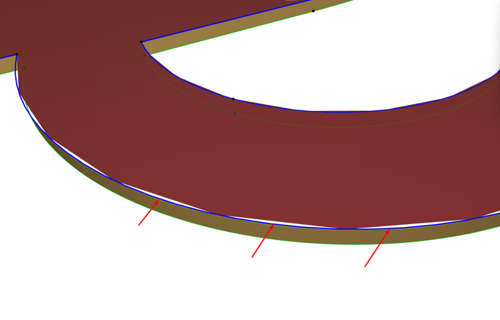

When I model a curved surface with the mesh tool or slab tool, I get a texture error like this when I look at 3D. Does anyone have any idea about the solution to this problem? It looks like there is a gap on the surface but there is actually no gap.
The changes I made to the settings of the magic wand tool did not do anything.

This is probably not a texture error. In archicad, there is no such thing as a perfect circle in 3d (not even in 2d), it is always represented by a segmented circle. Here, the upper plane is represented by a plane with fewer segments than the side. This is usually obvious with very small or very large surfaces.
A possible solution is to add the points yourself and give the smaller segments a curve as well.
