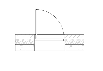

Mahmoud, this works in many cases, however it is not the same as mirroring.
Using this approach the inside / outside of the door is reversed, so for exterior walls and other applications where this matters, you might end up with more work in the end, not less.. see attached example.
BEFORE flip+mirrorBEFORE flip+mirrorAFTER flip+mirrorAFTER flip+mirror
