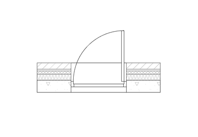

Mahmoud, this works in many cases, however it is not the same as mirroring.
Using this approach the inside / outside of the door is reversed, so for exterior walls and other applications where this matters, you might end up with more work in the end, not less.. see attached example.
BEFORE flip+mirrorBEFORE flip+mirrorAFTER flip+mirrorAFTER flip+mirror
You’re right David it can’t be done without extra work, I think it would be better if you can explain how this task could be achieved simply in order to be a practical wish more than a general one, thx.
AC 29 INT 4006/WIN 11
david_skogvold
Well, to my mind, this should be done in one click, just like how Flip or Rotate works. Simply select any number of doors, then Edit>Mirror, and done. Keep an option to input a mirroring plane for the (relatively few) occasions when you need that.
