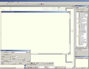

I was wondering if anyone had problems with elevations disappearing...it has happened with a few files, and not all the elevations but a select few. Once I break the link from the model my drawing seems to disappear...see image. I'm at a loss...

I found that if you break the link before the section window has generated a model view the first time the elevations will be blank. Revert the window to the 3D model and generate a view and then change to a drawing window.
Thanks for replying Millard, that doesn't seem to be the problem. I usually draw lines over the model elevation until I get into late Design Development...then I break them for more detailed elevations. Sometimes I can see the drawing in the navigator screen but nothing appears in the elevation window...any other suggestions???
