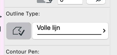

You won't see the 2d lines of a complex in the section or on plan only the contour attached to files.
Make sure every fill has an outline in the complex profile.  Select all the fills and add the outline.

Do you have Outlines turned off for any of your CP wall parts? Not sure if that does anything...

You can also select specific fill edges to toggle outlines on them seperately.
