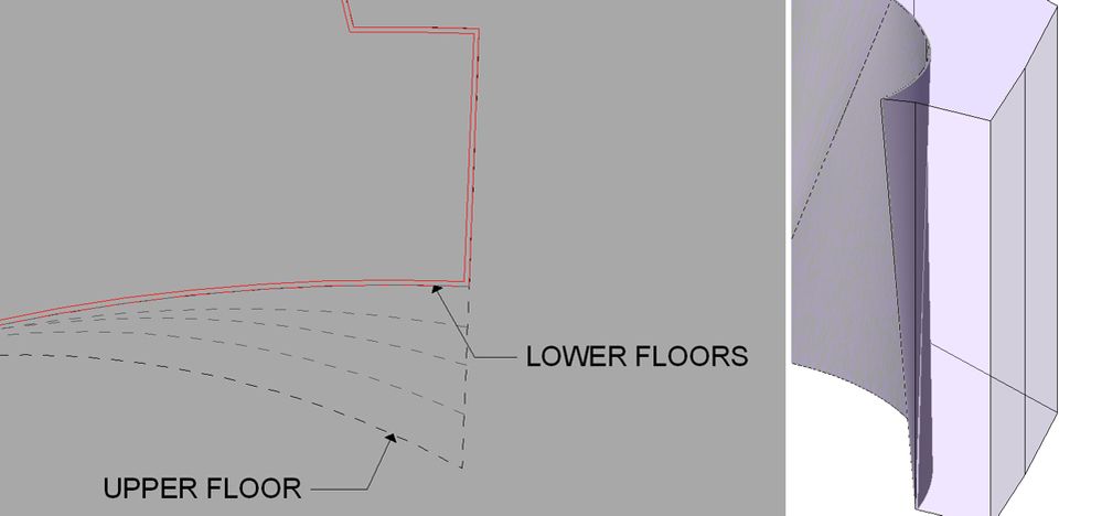

I tried using profiles, mesh tool and roofs but no luck. Any ideas?
To make things worse the profile of the tilt preferably should be a curve.
(Yes this is a proposal for a real project, and I have no idea how they do a curtain wall system for something like that)

I'm not sure it is something that can be done easily (if at all) in 'vanilla' ArchiCAD to a sufficient level of detail.
One technique you could try is to distribute a series of walls along the lowest curve, then in 3D cant each wall individually over until the top hits the highest slab. This doesn't work well for a doubly curved wall (see lower image). For the glass, try using a mesh with the contours set to the storey heights. This approach may be passable for visualisation purposes only. Detailing it to the level of construction drawings may be difficult!

So i sat up tonite because i have no other life and solved it. With the Complex Profile. What else is new?
I am starting to feel like the father, Gus Portokalos in "My Big Fat Greek Wedding" who claims that all English words are derived from Greek. Even "kimono." In my case: every trick in Archicad comes from the Complex Profile. That's all you need. That, and Greek.
Draw the elevation window mullions as a thick, complex profile wall [priority 0], then use two complex profile BEAMS [higher priority] to trim away the shapes in a "J" shape. Tilt the trimming beams for the distortion.

Just to clarify Dwight, I'm guessing you are using one profile to cut the front and one to cut the rear face of the wall.
Regarding the actual wall that is displayed, instead of using another complex profile perpendicular to its length, could you just use a thick normal wall with normal window openings in and SEO the curved shapes out of it perhaps?
If we are allowed to use SEOs, (even though they don't display properly on plan), you could even use a large diameter sphere library part as an operator and subtract that from the front of the wall.
To cut the rear you would have to subtract another sphere from a block, then subtract the block from the wall.

Yes, Two profiles since a solitary profile describing both faces is too large. See the first posting for two "J" shaped fills - these are them!
Now - the way things are right now, you can make a curved profile with the wall tool or a tilted profile with the beam tool, but not both.
There is a polygon limit to this operation - a smooth sphere is too big - I'd make a curved wall with a curved profile as a stand-in for a sphere.
