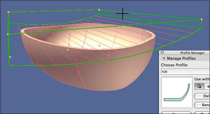

I'm using a complex profile shape to slice the top.

Here's a better view of that cutter.
Dwight Atkinson
Dwight
The swoop passes diagonally over the top to get the non-symmetric profile edge
Dwight Atkinson
Chris Grantham
wow, that is pretty slick Dwight. Thanks!
